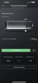

My car was charging fine then yesterday I plugged it in overnight and it hardly charged . Today it won’t charge again
I have not changed any settings and looking at the charger it is looking for approval to change as it says approve in the app
When plugged in now it does not go straight to green
The car app I managed to approve it last night it went green but must have then stopped as it didn’t charge
I have no scheduling set and I have rebooted my charger

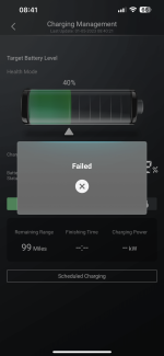

If I try and approve in the app it keeps on saying failed
Any ideas ?
Any ideas ?View attachment 17229

Just went to a fast charger - plugged it in and asked to app to start charging - it went green and started charging but then stopped after a few minutes

Just trying to charge to max as per usual

However if you're having problems at another (public) charge point then the issue might be to do with the car's onboard charger.

I don’t usually have to use the app to start any charge - I has worked up until now
I think it’s an issue with the car as I plugged it in when I got back and it started charging - all very strange
Mine also prefers to be off when charging, it won’t accept the charge unless I either lock or turn off in the safety section of driving.
It's really interesting how different the cars seem to be. Mine always starts charging right away, wherever I plug it in (AC or DC - no difference). It doesn't matter if it's turned on or off, it just begins charging.
