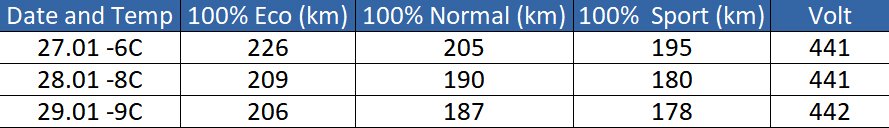

The point not being really the reported range (I'm not sure that is quite accurate.....more of a guess by the car based on driving history), but the battery volt reported on a full charge. I've only charted 3 days so I'll update after doing this for a while.
The figures look right.... the voltage is increasing, but as the temperature drops the range decreases. That iis to be expected.
