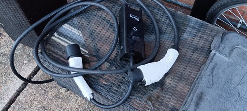

You might pick up an old Ohme type2 EVSE that will plug into your dumb Rolec but they are becoming harder to find now.

Is that something like this? We need to purchase a cable anyway so that could be the ticket.
NO DO NOT BUY THIS as it is type2 to type1 for use on a Nissan Leaf.
You need type2 to type2 but you can't really use is at destination EVSE units just to convert dumb units to smart.
OK haha, I won't buy this.
