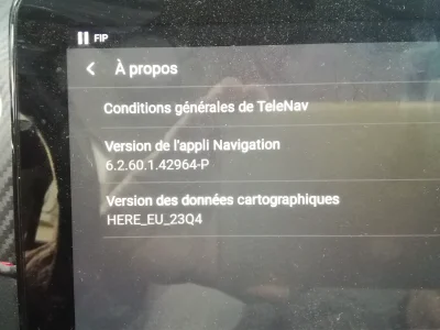

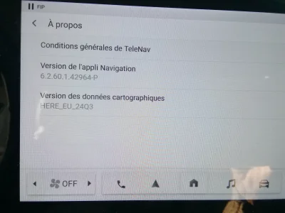

So I succesfully updated my maps in my ZS EV Standard bought in France
Before update, map definition was 23Q4 and after 24Q3
We can then say that the update rate seems to be yearly, but with a 18-month delay ...

We can see HERE_EU_24Q3 on the map definition
EU stands for EUROPE for sure

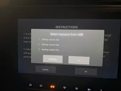

Upgraded mine today via the eu website. There is a zs ev uk spec on there.
It takes a while. First I got the select resources screen. It took a while but map appeared and I ticked the box . Then it took a good half hour to upload. It then checks the files and asks you to reboot.

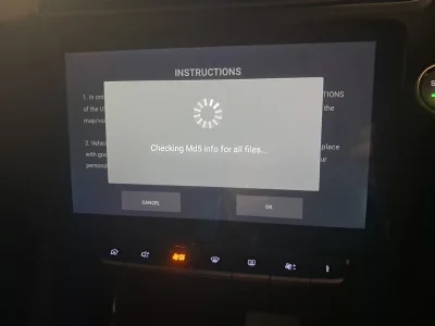

Downloaded the files and put them on a freshly NTFS formatted thumb drive and deleted the 2 files "File_Verification" and "versions.txt" but this time i still get the pesky MD5 hash error.
I have done the 2022 to 2023 update but this time it does not want to do it, it seems.
Will probably have to try downloading again, unpacking and copying to the thumbdrive once again.
Really pisses me off, it having to be this difficult, i fight this stupid navi every time i go to update it.
Once you have downloaded the zip file you need to extract it and then copy the 'maps folder' to the empty thumb drive. If you delete anything from that folder it wont work.
If i copy the maps folder to the root of the thumbdrive i get MD5 verification error, i have had this problem with previous updates, as has many others, but if you delete 2 files it usually works, but not this time.
Last time it was file_verification and vn.txt, this time there is no vn.txt, but a versions.txt, i tried both, with only deleting file_verification and also both that and versions.txt, but it still fails.

What I did notice:- If I didn't give it enough time from the instruction screen on how to update before starting the update it gave me an error message that the usb drive wasn't recognised. I had to wait around 1 min before dismissing the instruction screen.
Redownloaded the map update file, extracted it and put it on another USB drive of the same make and model and the car now updated the maps without issue.
Tried comparing and both drives contained the same amount of bytes and the same number of files so very very odd.
But as said...Now i have the "new" maps on my car as well, and did not need to delete any files to get it working like the previous 2 times
