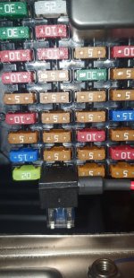

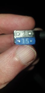

According to the Viofo install video on YouTube he mentions Mini so I bought Mini piggyback and fuses and they match on the mk2 ZS. The blue is the supplied 15a cigarette lighter socket.

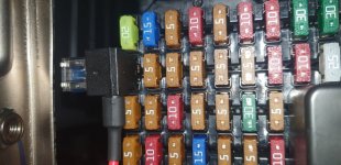

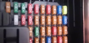

Got no idea what I've done wrong here but dashcam wont turn on when engine is on
You have to use a Switched live circuit (for example radio or lights).
I have mine in a permanent live circuit, which is fine unless you park up for over 10days with the camera running.... don't ask.
I belive I am using a live circuit as it's the same as OP's? #15 which is front power socket
