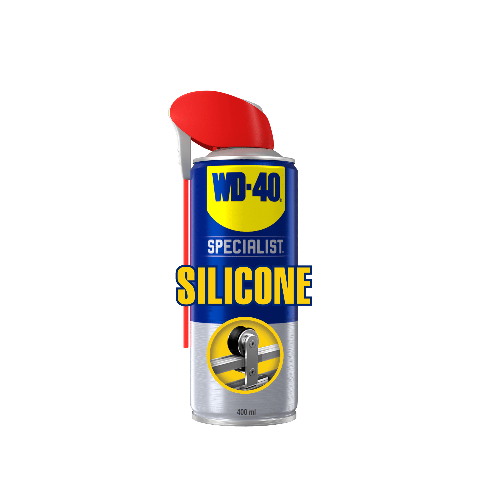

Aside from the fact that there may be a mechanical fault in some instances, I found that on both the gen 1 and the gen 2 ZS EVs, that the dooor handles could stick or stick open when there was bad weather & a lot of rain. In any case, the preferred solution is Silicone spray:
Since I treated all the doors and the boot latch with this in both cars, the problem never returned, well not yet.
[ Edited moderator: silicon → silicone ]
