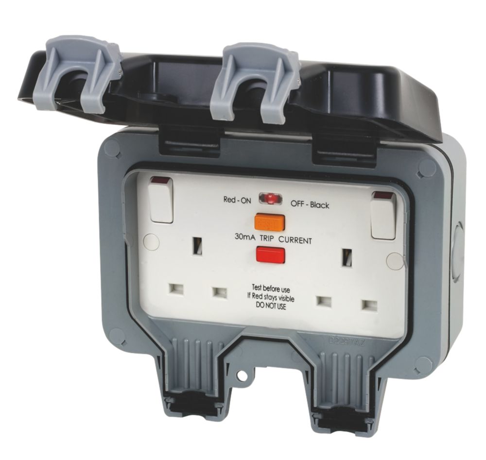

A weather proof IP65 rated 13 Amp three pin socket outlet installed on a outside wall, fairly close to where your car is parked, would suit you down to the ground !.
Just to give you an idea, something like this maybe suitable, but check with a spark first.
Ideally wired on it's own dedicated circuit from the C.U. ( Sorry, fuse box ) and your all sorted.
