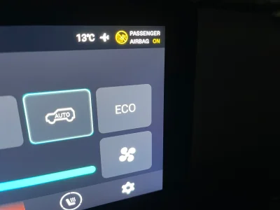

A few days ago I noticed that the MG iSMART App can't find my MG4. Yesterday I checked the car and it shows an airplane in the top right corner. Is there a setting that can cause this in the infotainment system? I also tried a forced reboot of the system (pushing the home button 30 sec.). No change.

Funny....but how would you call that?
BTW: This is from the car. You can test this, by declining the privacy settings.

Left-field thinking ... does it suggest that the Privacy etc. tick boxes have lost their settings, so you'd need to go through and tick them again? (Maybe untick then tick).
Yeah...it was the privacy settings. The signal bar is back again.
