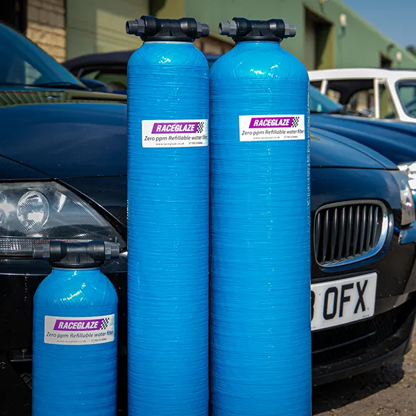

I did a bit of research on RO/0ppm filters and I'm considering this
Not sure if this is overkill and if the 7 litre option will be enough. I'm thinking I'll rinse with this after my monthly application of bilt hamber touch on then dry with my car blower. Should allow good sheeting so expect easier and faster contactless drying!
Are there any reverse osmosis filters/machines you can buy and install to connect a pressure washer to?
With my RO/DI machine, it produces 100 gallons of pure water per day. I do get this output but when you see it in action it’s a trickle and not enough to feed a pressure washer by any stretch. That’s why I store the pure water in a water butt and run the pressure washer from that.
You can get commercial systems that would feed a p/w but cost prohibitive unless you are setting up a breaking bad style car wash, have an A1 day.
I did purchase an 11 litre DI vessel that you fill with resin originally. You can connect that to the p/w but the problem then is you are forcing the water to flow through faster and this means the DI process is not so effective. If you are getting one, I would go for the 11 litre and I would connect to a hose for final rinse, not the pressure washer. It works really well but depending on the TDS level of your input water, you may find the resin doesn’t last that long. If you don’t have one, suggest get a TDS meter so you know what you’re dealing with.
DI vessel - pros: quick and easy setup, portable, easy to use. Cons: resin may not last as long as you hope and it’s not cheap, not good for feeding pressure washer
RO/DI system - pros: lots and lots of pure water, can feed stored water to p/w. Cons: More involved to set up, higher outlay (but not silly, mine was circa £375 all in), need water storage for pure water and ideally waste water also (unless you want to pour all of that down the drain)
RO/DI system - pros: lots and lots of pure water, can feed stored water to p/w. Cons: More involved to set up, higher outlay (but not silly, mine was circa £375 all in), need water storage for pure water and ideally waste water also (unless you want to our all of that down the drain)
I had a good feeling just from my limited research that I wouldn't be able to run my own direct from the di filter I linked but it seems that I'd only need to rinse with the 0ppm water so I'd do all my wash routine and rinse with the PW then just connect the filter and standard hose pipe to finally rinse the pw water off.
