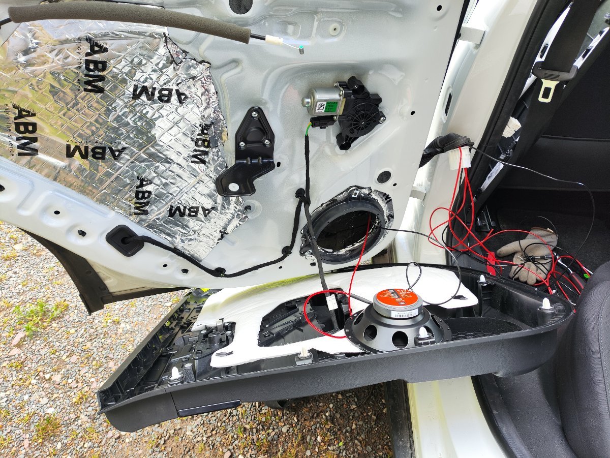

Hi everyone. I am also planning to install rear speakers in my SE. The only uncertainty is the connector pins. Could someone provide photos or measurements of those which did work?
Hello
You can follow this link and you will find what you need.
It's my tutorial, in French but with deepl, it's easy!
@Fernandnaudin thanks a lot for the link and your work documenting the process. That brought me further quite a lot. Do I understand correctly that the linked connector pins are those for the door through connector? And not for the amplifier itself?
They work for both.
But for me the door connector doesn't have sense.
