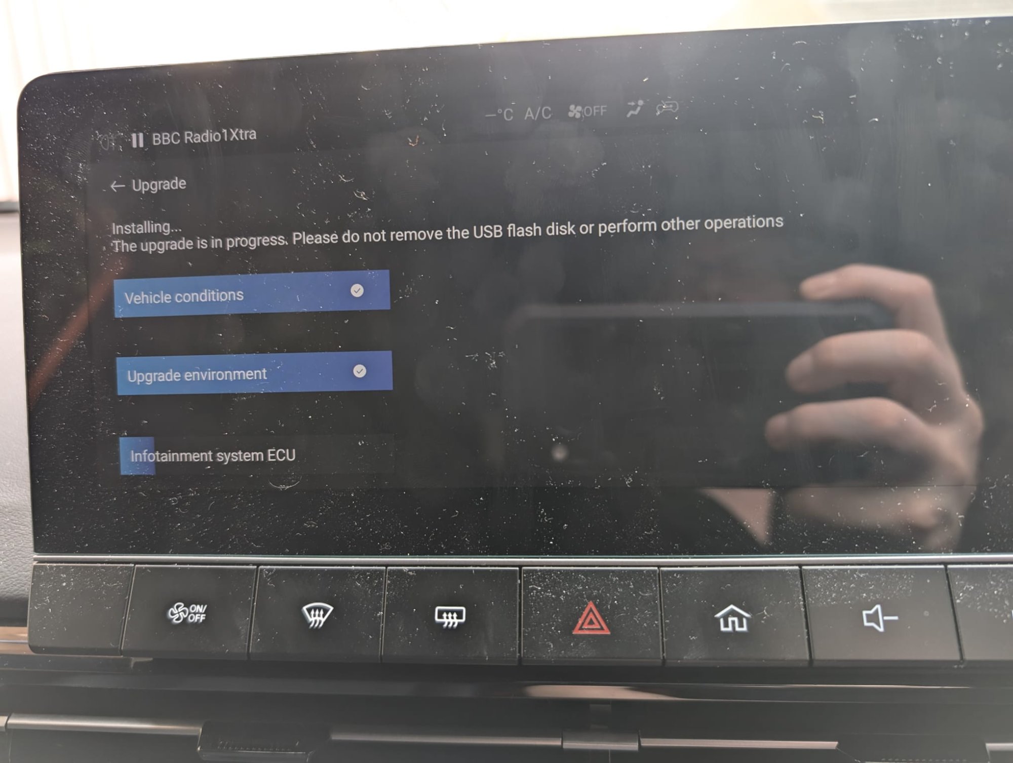

Files are here, they say to use a 64GB stick formatted to FAT32 (have to download a program to do it, I used Rufus)
Tbh its just copying the folder & 2 files to the USB stick, plug in either front USB ports (A or C)
Enter eng mode
USB update
AVN then ECU
Doesn't take long
It's a full update so can be loaded over any version
Below is the ECU loading but looks the same as AVN
