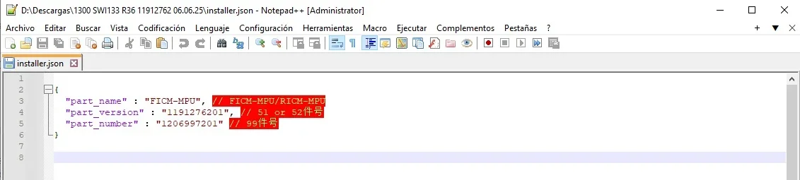

There's the problem, the folder structure seems not to follow the previous SWI-branches.
Using the folder AVN_MPU wasn't successful, using the root folder wasn't either.
I also tried a bunch of other folder names...
The installer.json file names the FCIM-MPU folder but doesn't mention AVN, in case that helps.
I'm not familiar with the engineering mode structure of your vehicle, so there might be a new section.
I tried some folder structures with "FICM-MPU" and "RICM-MPU".
Unfortunately without success.

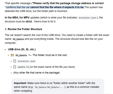

Investigating with AI, it says this:
What the AI says is that it makes a call to the .51 file, but the file is usb_ota_update.zip.
Solution summary:
  1. Format the USB drive in FAT32 (MBR) .
  2. Create the folder SW_Update.
  3. Copy the installer.json file.51 into that folder.
Well, the AI feature isn't working with the SW_Update folder.
I have a colleague here in Spain with the same problem; he's tried renaming it, leaving the .zip file, and a long list of other things, without success.
