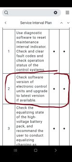

Module updates should be part of the service.
