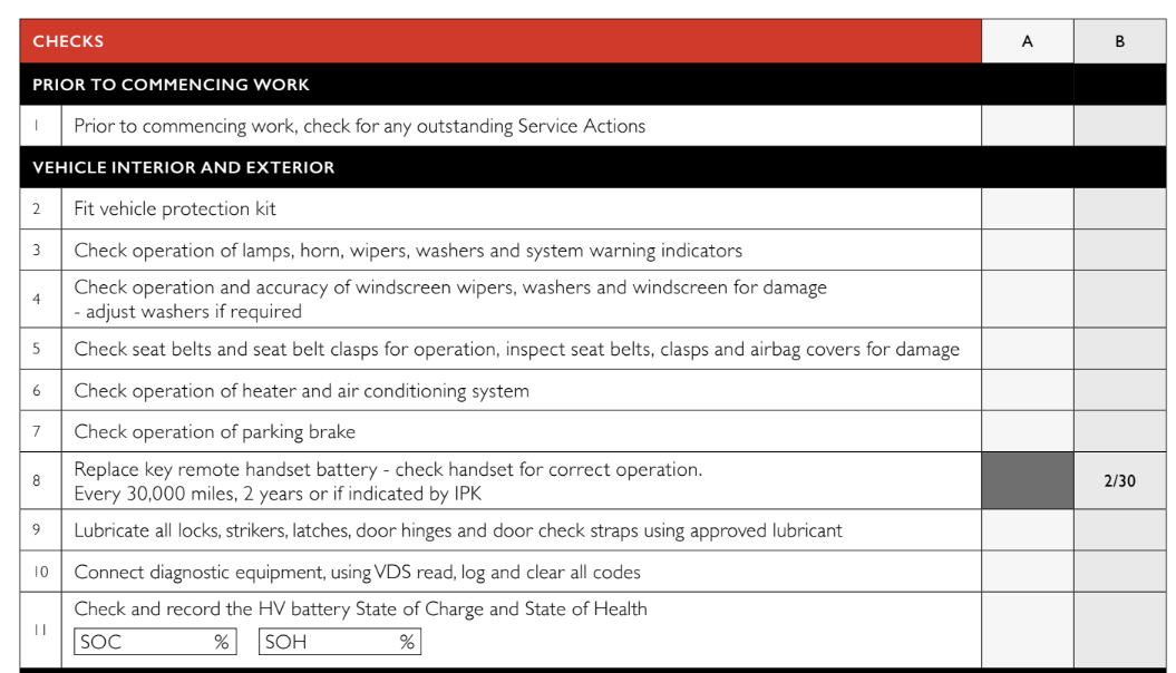

That's not part of the revised maintenace check sheet anymore. Any service will strictly follow that.

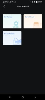

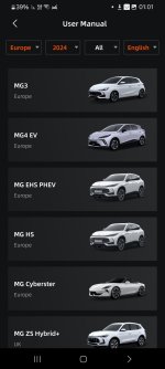

Its still in the app under service portfolio

Diagnostic procedures? Three books?
I have three pdf's in I-Smart. What else are you referring to?
