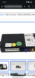

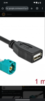

I think we need to connect a FAKRA to Usb adapter directly to the tbox usb connector its the black 4 pin connector and extract the corresponding files on the usb drive and execute the update.The special PROGRAMMING TOOL is just this adapter cable.
An Mg technican was telling this to me......
