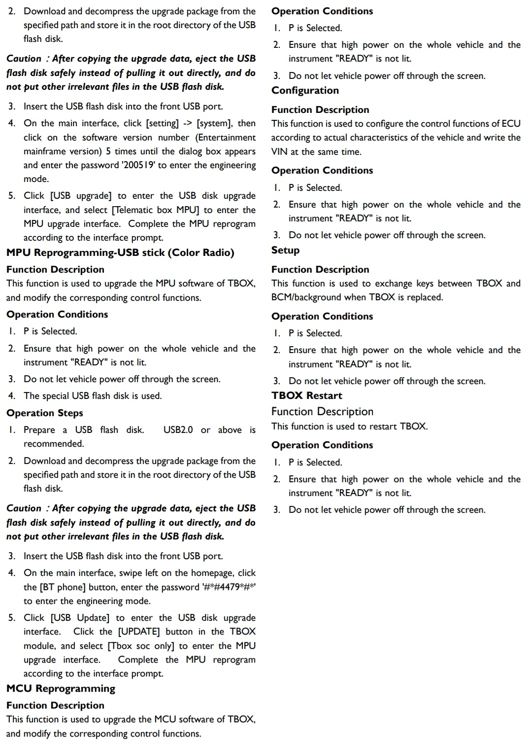

Which modules/ECUs did you update, exactly?
It’s not straightforward. My understanding is that you need a specific FAKRA-to-USB adapter to connect. These adapters are available on AliExpress at a low cost.
you can check out this post:
Added to the drive
Checked several vins and they have either come up with 1 or 3 files, all 4 are in the drive
You can open the files with a zip program like 7zip winrar etc
Never loaded one but would expect that you just extract it to the root of the drive
Here's what MG say
has no one here ever done it?
Then where to connect this adapter?
