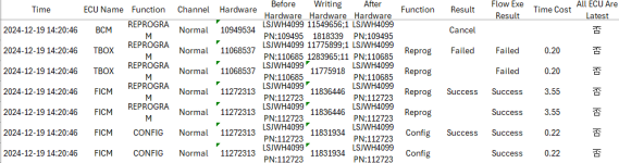

It was fix yesterday by dealer, I don't know what they do but I found this :
And I know MCU was updated from 68.4.3.0 to 68.4.7.0
FICM Is the MCU, they upgraded it via sips and then reconfigured it as standard MG update procedure. I guess R63 requires that. There's a 68.4.6.0 in the wild as well so that may work too

They just need to plug the car to SIPS, read it and perform the right updates (FICM for sure, maybe some others)

I can confirm that upgrading MCU to 68.4.7.0 via SIPS solves the the in-car charger % setting. I'll report back today if 68.4.6.0 is compatible as well (that update got released after R46 was out and I have some cars with that version already installed)
