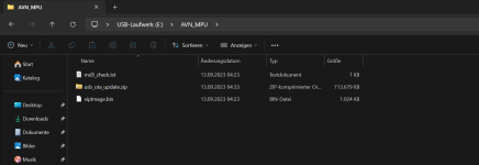

Hi, usually I am not an idiot, but this downgrade seems a little bit rough...
I put a folder AVN_MPU in the root of my fat32 usb stick. In this folder are the 3 update Files from the R38 (md5_check.txt, usb_ota_update.zip, vipImage.bin)
In the update menue I have the options DAB, ECU Infotainemnt, AVN MPU, MPU Telematik, ECU Telematik.
I can only update ECU Infotainment, then a upddate with 3 blue bars is running, after a reboot I am still on R63.
When trying to update the AVN MPU I get an error message with "Upgrade package from usb drive not detectet"
What am I doing wrong?

From R46/R59/R63, "usb_ota_update" file have to be in AVN_MPU folder, not" in the root
So create a folder "AVN_MPU" and copy usb_ota on it.
It's just written few post ago. You have to be careful with that if you don't want to brick your unit.
