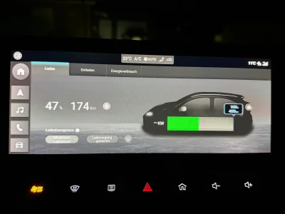

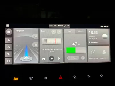

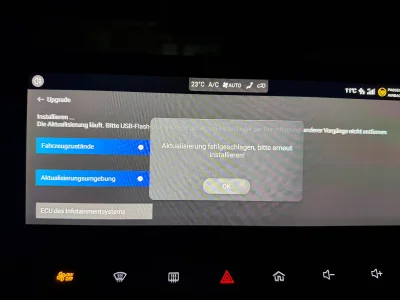

Hello everyone. I just tried updating from R46 to R67 on my 2022 Luxury using the file from the OneDrive link a few pages back. After the AVN MPU update, the system booted up as expected. However, the Infotainment System ECU update failed, and now it tries to run the update again every time I start the car. I also noticed that the slider for setting the charging limit is not functional. I then tried to revert back to R46, but that doesn’t work at all — the entire infotainment screen turns grey, and on the second page, I can only access the settings menu. Does anyone know this issue and how I can either complete the ECU update or revert back to R46 if necessary?

Could you post a few photos?

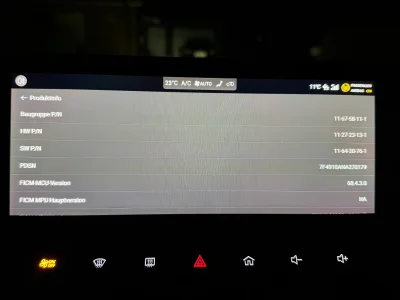

With R67, the MCU should be updated to version 68.4.7.0 or later. That explains the problem with the slider, though it does not account for the other bugs you’re experiencing.

Yes, you’re right the MCU software version on my system is lower, as you can see in the picture. How can I update it, or is that something I can even do myself? In one of the photos, you can see the message in German saying “Update failed. Please reinstall.” And as shown in the other photos, the slider doesn’t work properly. I don’t have any photos from after the downgrade to R46, when the entire infotainment system stopped working, and I won’t have time today to reproduce it. But maybe you can help me get R67 running properly.

The error seems to be related to your USB drive not being recognised as containing an update package for the MCU.
Indeed, the latest MCU firmware (what is called here ECU) is not provided with R63 update package and needs to be installed through SIPS.
SIPS is a windows software that connects to your car via an OBD dongle. Using it requires more commitment than simply sideloading an update through USB.
If you can’t access SIPS, you can revert to R46 or R59 seamlessly: just download the relevant package to an USB stick and update the MPU.
I’d suggest downgrading to R59 rather than R46 because it’s the latest version unaffected by the slider’s bug.
