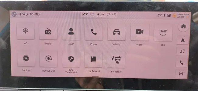

Has anyone got the built-in route charging assistance that @Odin reported they received with their R59 upgrade. And this was added to by @Mouss. See below
Also see pages 12 and 13 in the MG4 Trophy map update - beware.
The planner is not a feature integrated within the navigation. It is a standalone app. So you have to open the planner, select your trip, and then, the route is sent to the navigation app with the charging stops as waypoints. From this moment on, it’s purely static. It will not select other chargers based on your actual consumption or whatever.
