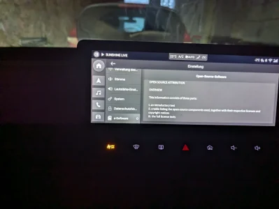

Otherwise, the open-source licenses have been added.
