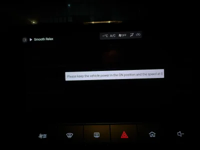

Hey, so I tried to update the MCU version via the menu, it first looked like it was all going ok, detected vehicle state all fine and said it would restart and apply the update..
When it restarted it said update failed. When it went back into the engineering menu it showed no version against the MCU. And as expected it can no longer communicate with any of the car modules... volume buttons do nothing, aircon controls don't work :(
I assume the only way to recover (short of taking it to MG) is to update via SIPS? I don't have the cables yet, but if I need to, then I'll have to get them...I can't even get into the engineering menu at this point, as it comes up with the message saying to keep the power on and speed at 0 (which is most likely because it cannot see the status of the car anymore!)

@AdamskiEM I’ll try to help you. But for that, I need to know all the details of what you did and what you didn’t do. Starting with which R version you used, what kind of USB stick you used, and how you formatted it. Also, of course, the info about the model year and trim level.
@DonBattino452 Hey, thank you. I used "1300 SWI68 R67" from Google Drive. Formatted the USB as FAT32 (formatted from Windows) and dropped in the files as they appear in the ZIP folder. So the vipimage.bin and md5_check.txt in the top level and a AVN_MPU folder with the ota update zip in it.
I followed the steps from this top post Trophy/Luxury 22/23 FICM loading guide but did just the AVN MCU step.
Is a UK Trophy, 2023 model (without the wiper).
It was showing the following (when I could get into it)
MCU: 68.4.3.0
SWI68-29958-1300R46
I was considering disconnecting the 12V battery to force the screen to reboot, but then I'm worried it won't detect anything and stay turned off..
When I lock the car the screen is basically on forever now :(

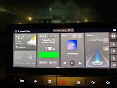

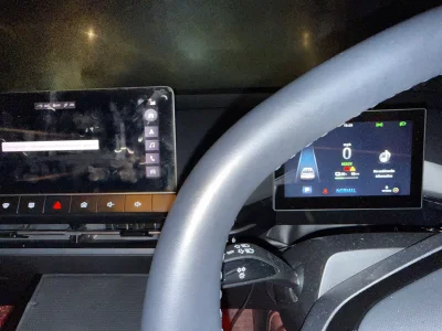

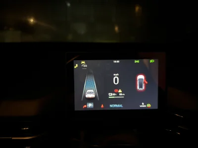

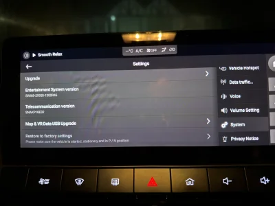

I didn't see that part. Show me your screen please, main and setting please
Here you go. Error is when I try to enter engineering mode.
Battery is actually at 35% charge. No temperature. A/C screen is all greyed out, and the radio doesnt play either, no doubt because nothing can communicate with the rest of the vehicle

Your problem is the car: not in ready. You can't turn it on ?
Yeah. I turn it on but it’s the same. You can see from this photo it’s saying ready, and still erroring (not the easiest to take at night)
