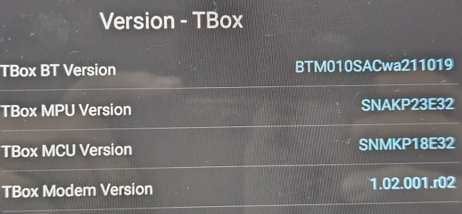

No first MPU.
There is a message when you try to update MCU when MPU isn't up to date.
Last MPU is SNAKP23E32 for MY22 and MY23
I'm bit confused. I came from service yesterday after complaining for old TBOX versions. They worked on the car for whole day but there is still SNMKP18E32. They claim that's latest from SIPS. Also gemini says that's ok. :)
So is it good for my MG4 SE (MY2022)? Thanks. 🙏
@kurnos I'm going to install R45 and make all SIPS updates for it next week. I will make some pics of version numbers so you can check. We both have the same model 😉.
