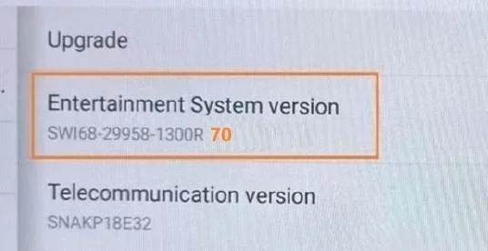

It has led me to confusion when reading @haloweenhamster's post.
The Drive file says R71 but the PDF says R70.
The R70 pdf comments:
First, Saic1.0+ is an internet Front Information control module, SO you can see 4G signal icon at the Top, if here is no 4G signal ICON, the Front Information control module is a Color Radio The software only match with saic1.0+.

This is the first time I've updated the FICM via USB, and I'm confused by the Word and PDF documents, which seem contradictory for both models.
I thought the software for a Luxury model wasn't the same FICM as the Standard "Spain", but I see they're identified the same way: SWI68-29958-1300Rxx. I'm missing something, though.
Sorry for my confusion regarding the model differences.
