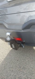

Hi, yes I had it done a few months ago. Great job done by Kits n Bits in South Wales. Genuine Witter MG4 tow bar and electrics. The electrics connector slides up and away when not in use, and the detachable swan neck towbar holds my bike rack perfectly. There is a small cut on underside of bumper to allow fitting, but it is out of sight unless you bend right down to look underneath. I've attached the PDF of the towbar that was fitted.

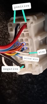

How and where did you connect to electrics for the towbar wiring?
There is a plug on left hand side behind charge port for a towbar.
But I suspect a canbus adaptor is required as there's only four wires that could be used (circled in pic (3) and the yellow wire) and there they don't switch 12v on/off like the stop wire (white/red) see pics. They have a control voltage on them.
Is it possible to get the connector socket pins easy?
Any help would be awesome.
Doing the wiring for a mates MG4 now.
