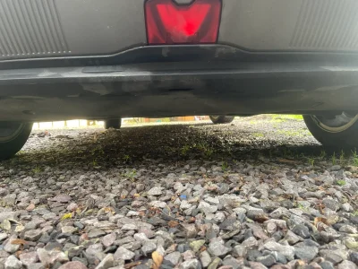

Late reply but I just fitted it myself.
.... no worries, just ordered one and likewise are fitting it myself - still got the electrics to do - but the main frame is millimeter perfect (so no redrilling of the holes), and also managed to refit the rear crash bar / towing eye - all I needed was a small cut out, which is only visible if you're 6 inch off the ground -no need for any further wiring aside from re-pining the terminator plug which included the live n earth (in the trunk/boot) 👍
