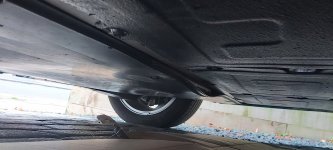

I contacted MG about the dip in the undertray that others also seem to have (noticed in oil leak thread). They say it’s not normal and would be replaced if approached by dealers.

It looks like the the engine/gearbox isn't sitting correctly and pushing the undertray down

I don’t think that’s the case. Think it’s just the angle I took it. Other pictures I’ve seen show similar.
Looks to me like the screws don’t line up and force it to bend. That’s what the dealer said who thought it was normal as all their cars had it

Can’t get a better pic where the car is but it’s definitely just a gap, not actually in contact with the metal. Has a lip at the edge that goes around the metal bit where it is flush
Are the bolts on your undertray fully tightened? They seem to be loose on mine. Misaligned bolts does seem like the same issue I'm looking at. I can't get it to the dealer until Saturday but I've emailed the customer service email and will be calling in first thing on Saturday about this and the leak.

Thanks. I will email as suggested and will have to contact dealer too. Think we are both same dealer. My car look similar with the dip. Not sure how good my pic is but this is what mine looks like...

Yes I think we are. I initially questioned it due to a slight whistle I get from the back of the car. Looked under to see that.
I can see why people including one dealer thought it was normal when there are so many like it. But if MG themselves say it’s not then best get it sorted.

I have been in and as per oil leak thread there was an overfill which has been corrected and in terms of the undertray there demo car has same issue. They say it looks like the tray is too big but ultimately they need guidance from mg on the issue. Obvs messing with it not an option at this stage. I haven't had a reply from mg yet but when i do i will forward to dealer and i would urge others to do the same and hopefully we'll get progress soon once mg have more info and examples. Dealer was helpful to be fair.

From the pictures it looks like some have the bulge at the front of the tray and some at the back, is this so ? ?
I assume if you driving motorway speed this will affect efficiency but also sound proofing as air going inside of tray? So if that issue get fixed your car would be probably a bit more quiet.
Yes it should be. I get a slight whistle from the back at 50mph + which I believe is caused by this.
