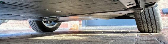

Thanks for the heads up on this, given that @ph79 & @jamesc83 came from the same batch / dealer I thought I'd check - mine is attched - its sagging about 1-2cm - mine is the smaller battery / & motor? (125kw) - I thought I'd jack it up for a better look - but couldn't find one in the boot :rolleyes: - only a can of gunk - now i know what that SoS button is for (which will be doubt stuck in middle of nowhere, without mobile coverage, when i need it! )

And here’s my underside. Utter shambles. Dealer informed.
Hard to tell I understand, but what do we thing is causing that bulge in that plastic under tray cover folks ???.
Is there something not fitted correctly UNDER the tray, causing it to bulge like that, or is it just missing a fastener in that location ?.
What is both more concerning and puzzling is how this did not get picked up on the PDI check prior to delivery ?.
Unless it HAS lost a fastener after it left the dealership of course.
It should be a simple fix but not expected this early in the cars life.
A few customers have reported missing or loose fasters also in the under tray.
Either not fitted correctly at the factory and how did they pass the quality inspection checks then.
Or the covers have been removed for some reason and never got refitted correctly ?.
It’s a strange situation alright.
Had the cars not been submitted for oil leak checks, then would owners be contacted their dealers anyway when the under tray dropped and was fouling on the tarmac I wonder ?.

From what others have said, the undertray problem isn't something hanging down pushing on the tray, it is due to incorrect or misaligned fasteners causing it to bulge like that. We don't know if this is a robot or human that puts on the undertray.
I believe nobody knew it shouldn't be that shape, so dealers were assuming it was intended. Now they know it isn't. They should be checking for loose or obviously misaligned fasteners though.
I just put mine on ramps to have a better look, it looks like the tray has distorted post production. In that if you push up on it it does go flat, but wont stay due to the warping of the untertray. The undertray is quite flimsy, with no support / strength ribs (which is normal on combustion engine undertrays). So in my humble opinion, the part which the rear under tray attaches to (its touching it, if you push it flat) gets hot. The other thing that I noticed was that the 4 x 10mm hex bolts (with 25mm washers on), were quite loose (just over hand tight) - which didn't seem right - attached is a picture taken inside the undertray from the left rear wheel towards the right front, yellow circled is the offending (in my opinion) heat source, causing the distortion??
Sounds exactly like mine. The bolts and holes in the tray don’t line up and aren’t fully tightened. I think this might be a delayed fix as imo it probably needs a new tray. Has anybody else had one of these fixed yet? The only way I can see dealers being able to “fix” it will be to drill new holes in the tray.
