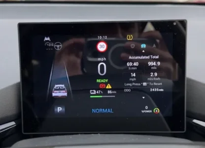

Has anyone had the TPMS light lit, on the Dash. (Tyre pressure). If you have.
Does it just light up, or does it flash. And how big is the warning light
Or does it Bing and bong, too.

It just comes on and stays on mate, not very big, and no bings or bongs, but it's the yellow warning triangle in the middle, and the tyre symbol at the top.
Probably a faulty sensor or system fault if it flashes when you start the car.
If it just comes on and stays on, it's indicating what it thinks is a pressure that is outside of the preset boundaries.
It's not unknown for tyre fitters to damage the sensors when they change tyres. If you have new wheels it might have new sensors as well in which case they'll need to be programmed to the car. Whoever fitted the tyres to the wheels should have done that for you...
If it's indicating a system/sensor fault, it'll be an MOT failure - when the time comes.
