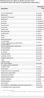

12 months for the battery! Why I wouldn't be keen on buying another.
