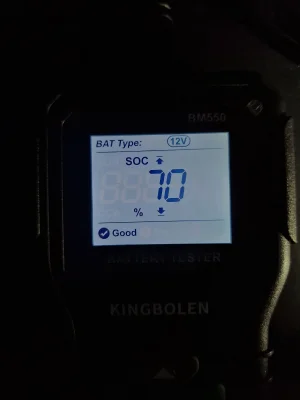

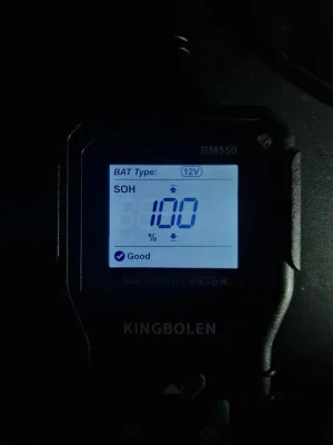

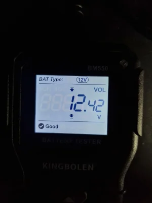

So the car has been doing its usual small journeys since the failure on Sunday and is going to do its "big" trip to Leeds in the morning. I thought I would get a battery reading before and it doesn't look great.
SOH = 100% - as you would expect for a new car
SOC = 70% - so its 28% down from Sunday but you should be good down to around 20%
Volts = 12.42 - this is about what you should see from a 70% charged battery. And an EV probably needs something like 11.5 to 12.5 to start up so we are good here.
The car is currently on charge ready for the trip in the morning. If I have time I will take another reading to see if charging the main battery does anything to top up the 12V.
I will also take another reading when I get back from Leeds to see how it looks.
We also have no plans to use the car Friday evening to Sunday afternoon so it will be interesting to see how it does without a couple of days use. Will take readings.
Something I have noticed though is my battery tester isn't as reliable testing this battery like normal car batteries. I think the battery is a bit of heap of junk to be honest.
