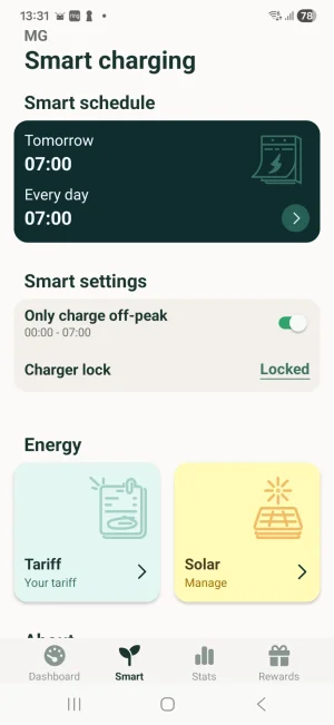

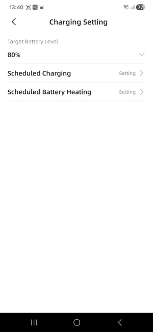

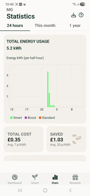

What you say above makes sense, with the five points. However, if the Ev app is set to smart charge AND the MG app is set to smart charge, a charge is only delivered at the times specified in the apps.
I only required a small charge yesterday evening (to see if everything worked) , and as you can see from my screenshot's the charge was only started at 12am (start of my cheap tariff) and finished by about 2am.
With all the hassle I have had with my 12v battery getting drained, I am obviously very hesitant to give access to my mg account, even as a secondary account, in case my battery problems return.
That isn't "smart charging"... That is schedule charging.... its also limiting your maximum possible charge to around 49kw (give or take). Which isn't a big problem most the time but it is a limit.
I know its under the smart charge features but your basically just pre setting a schedule. Thats not what most people recognise as "smart charging".
If it works for you then good stuff but I think we are looking at this from different positions. If you look at things like Octopus Intelligent Go - thats true smart charging and I regret not buying a charger compatible with it but the Ev Energy stuff isn't too far away. Schedule charging like this though isn't really smart charging.

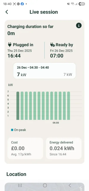

Just more evidence on how it actually works. I need 10% tonight which is just under two hours charging. Plugged in and ev energy has scheduled exactly two hours charging. It can only do this if it had all the relevant data points.
Hopefully this helps people understand how it works.
