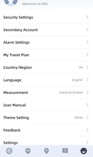

To make all this work properly you need to create a "Secondary Account" in the MG app settings. You then use this for ev energy. You will no longer get the message about being logged out.
You use the main account and ev energy uses the second account.
If you don't connect the ev energy app in this way you do lose the ability to properly smart charge.

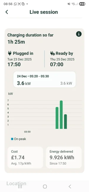

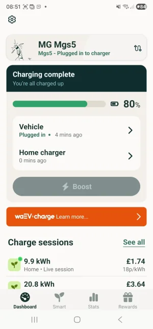

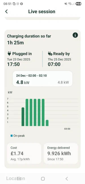

This should demonstrate what I mean...
I was doing a top up last night and only needed something like 10-15 % or so. Can't exactly remember.
Because the ev energy knew i only needed a small amount it could schedule the smart charging to make full use of the smart charging algorithms.
Without this it would have started to charge much earlier with no gap like you see in the screen shots.
