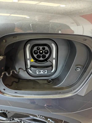

Presumably some MGS5 owners can just have a look at the connector on their cars to see if pins L2 and L3 are present? Obviously, pins being present won't guarantee that the car supports 3 phase charging, but if the pins are not there at all then it definitely won't be charging above 7kW single phase.
No L2 or L3 pins 😭

I think he was just showing where the pins should be located. On that photo they are missing.

I am sure my UK Spec MGS5 Trophy doesn't have the 3 phase pins in the car side of the charger (I may have to double check if people say otherwise)... so it won't matter what cable you have?
You're right and I now feel daft. Not for the first time so hey.
Yes I should have checked the car side. L1 only.

My mistake, my S5 is L1 only. I should have checked the car side first.

My S5 trophy definately doesnt have 3 phase charging pins on the car - just single phase - the 2 other phase pins are missing. I think its european models that have the 11kw charger on board.
