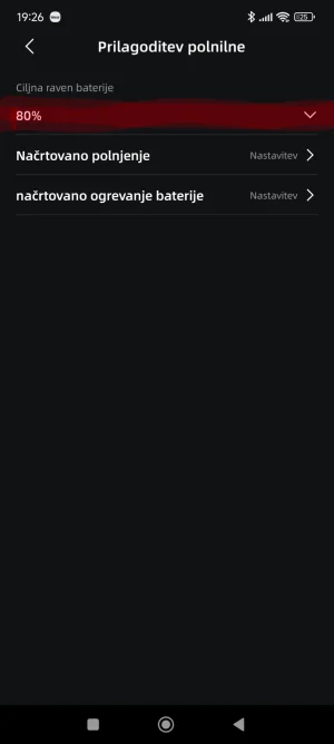

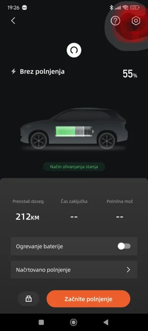

I have the LR battery version There is no way to change the percentage bar in the battery screen cannot be adjusted nothing happens when I tap or try to slide it. It is the same in the app, I cannot change the percentage bar, and there is no target battery level option in the APP.
Not sure if the app is same my looks like this.

This is how my MG 4 LR (64kWh) looks for the infotainment screen with the slider to adjust target percentage.
And for the iSmart app on the main page
And then the ev management page
I notice someone has posted the displays for the MG S5. They don't differ much from the MG4.
