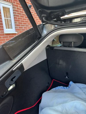

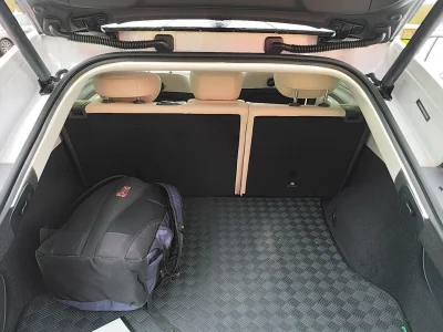

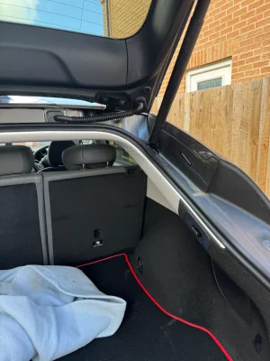

There you go Nik, you can see they come down each side about half way

That looks perfect. Nice and neat too.
To be honest they really light up the boot area very clearly. I did look at the ones that go all the way around but as I said I was worried that I’d end up crushing the lower ones when loading the boot with heavy stuff.
The hardest part was feeding the power cable through from the boot light but once you get it through the rest is easy - and they work 😎
Hi Don,
Thanks for this; much appreciated. So it appears they did send me the right ones. I got misguided by the fact that their onsite videos have the ones that go around the full boot.
Will give it another go tomorrow (installation wise). I was 90% done and took it off....

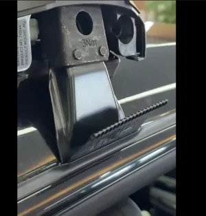

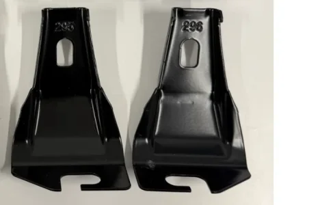

Right; so I got delivery of the bars yesterday afternoon.
The kit (Thule) consists of the following:
Foot Pack:Thule Edge clamp on feet (4) no. 720500
Thule Edge WingBar black:1 x Thule Edge 104cm black WingBar and 1 x Thule Edge 98cm black Wingbar
These are the ones that I already knew that are compatible from the various videos and pictures I saw on Chinese sites.
As for the footings....they are the Thule footing kit 145114.....from the Audi A5 lol.
They look like the attached picture.
I didn't have time to do anything with it but I can confirm that they fit in the car as per the second attached picture. This is not from my car; it is screenshot from a video supplied by the Chinese vendor. It went on mine the same way though.
I will try and find some time this weekend for a full installation.

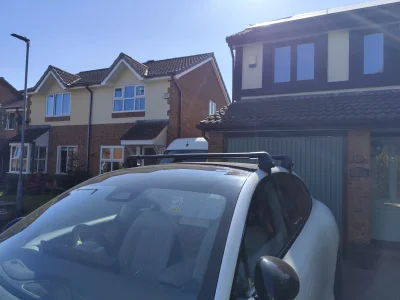

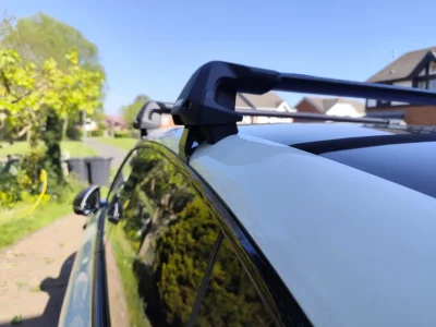

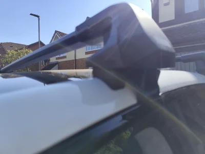

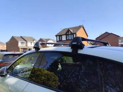

Ok...done...it wasn't easy to start with but once I got the hang of it it didn't take long.
Looks quite robust. Significant distance from the glass roof.
