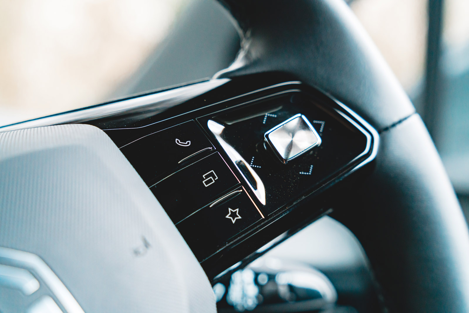

MG4 Trophy (which we both like other than the clunky touch screen) has now lost the data in the bottom right corner of the driver's display - total miles, trip miles etc. This has been replaced by the same GPS symbol as is on the home screen of the central display. We still haven't got our head round the GPS.
I have tried hard reset by disconnecting the 12V battery for a couple of minutes but no change. Any other suggestions ?
Press the middle button on the right side of the steering wheel (looks like 2 interlaced boxes), then move the thumbstick left and right until you find the screen you want. Then press the wheel button again to lock it in.
That middle button on the left side, making the right joystick multifunction, was the first thing the dealer showed me on handover.
