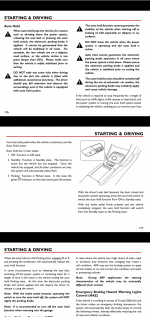

Thanks. Does anyone know what the difference is between the auto-hold and the handbrake? They seem to do different things. Does auto-hold apply the front brakes and the parking brake the rear?
The auto-hold uses the handbrake. When you come to a stop it engages the handbrake automatically, pulling away it automatically disengages when enough torque is applied to stop it rolling back.
The Hill Hold Control uses the cars brake system by holding brake pressure after the brake has been released to stop the car rolling.
Hmmmm. I don’t think it does
If you try pulling up on a hill using auto-hold - then apply the parking brake - the car rocks back after being held on the rear brake.
The handbook is confusing. It says the Auto Hold puts the car in park.
yes - the user manual is not great. I think that the auto-hold applies pressure to the brake pads holding them on the discs - independent of the parking brake function - but I could be wong!
