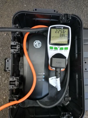

3. I assume you mean an AC (granny charger) that plugs into a domestic socket. If so, I have a power meter that I can insert between the socket and the granny charger that can be set to calculate the cost of the charge. You may be able to get the same in your country. Granny_Charger_Box.webp

Re. question 3 ... when I'm away from home and using the "granny charger", I note the starting SoC % and then start charging (usually to 100% but not always). When charging is finished I calculate the difference in SoC %, multiply that by the usable capacity of the battery (50.8kWh in my case), divide that by 0.8 (to account for efficiency loss - not all the electricity from the supply goes into the battery pack), then multiply the total kWh by the unit rate for wherever I'm staying.
An example:
Start SoC = 20%
End SoC = 100%
Difference = 80% = 0.8
kWh into battery = 0.8 x 50.8 = 40.64kWh
Efficiency loss adjustment = 40.64 / 0.8 = 50.8 kWh
Unit rate = £0.25/kWh therefore cost of electricity = 0.25 * 50.8 = £12.70
It appears the charging efficiency of the MG4 varies when using a granny from 84% to 89% on my own vehicle.
1.9-2.0kW going in to the car
vs.
2.22-2.26kWbcoming out of the charger @ c.243V.
I haven't measured mine - I just made a guesstimate. But see also below:
That 1.9-2.0kW going into the car also includes power used by the car, so of that 2.0kW maybe only 1.7kW is actually going into the battery. :)
I don't think that's correct, the car (and a slight loss in the external power cable) is using the delta between these two measurements. The delta accounts for both heat in external cable and car wiring along with the car's electronics/modules . The cable cannot be losing the c.300W in heat else it would be very toasty after the many, many hours of charging. My "granny" is actually an Ohme 3 pin, so the power usage I am reporting is the output, and not the EVSE input power (which is slightly higher if I measure using a Tapo Smart plug).
I wasn't saying your calc was wrong BTW, just the figures I get using my equipment.
Are you actually measuring the 1.9-2.0kW? Or taking the reading via iSmart?
Anecdotally, the car uses 300W of power whilst charging ... for local electronics and charging up the 12V battery. :)
When the car is turned on it uses 300W as displayed on the screen (1.9kW drops to 1.6kW) when leaving car on charge.
The figure i used above is from iSMART and shows 1.9kW with car turned immediately off, as electronic systems drop offline this decreases the cars parasitic consumption leading to increased charging of 2.0kW feeding battery.
The car is being fed with 2.25kW by the Ohme, so the loss are 2.25kW minus the 1.9kW/2.0kW battery input.
This is how I calculated the percentage figures above. Further unmeasureable losses will exist within the cells and controllers, hence why I wasn’t criticising 80% efficiency as it’s likely to be a round trip of close to that (especially when a year round average is used to account for colder weather).
