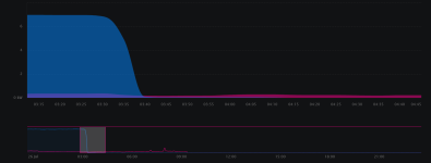

The car cannot tell you if it has completed the balance charge after it has finished but your EVSE (charger) should be able to, unless you are using a dumb one like the granny.
Attached is my Zappi report from last night when I did a charge from 4% to full - if you look at the blue line it drops from 7kW at about 03.40 and balances until 04.10 (it is just about visible but low down!)
Attempted our first balancing charge after finally getting the battery to 10%.
The Givenergy EV info doesn't seem as detailed, but you can see here that the power dropped to about 50% for a half an hour before finishing. Then there was a little 850W charge 20 minutes later, presumably part of the balancing process.
