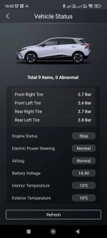

The MG app shows the current 12v battery voltage.
Towards bottom of the vehicle status screen

As a matter of interest does the app show it raised during hv charging?
Macadoodle, yip my mind was on normal day to day charging but intelligent charging, with the caveats as stated, should kick in to top it up
Ayoull, be interesting to understand the SOC parameters to enable intelligent charging.
As a matter if interest does the app show it raised during hv charging?
I've never really checked while it's charging before, I know while the HV battery is pulled in it floats at 13.2 - 13.9v
