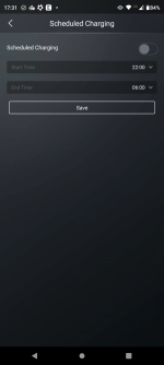

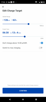

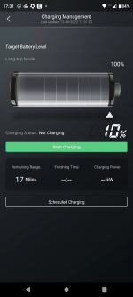

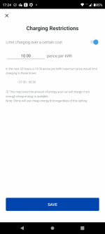

It's the Home Pro, trying to use Ohme as I can't set an end time on the cars scheduling, only a start time, and as it's the SR I can't set a target.

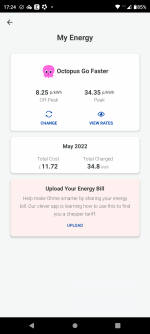

I've set it up and set to only charge at under 10p/kw (current unit rate is 8.25p).
Screenshots attached (hopefully), and thanks for replying!

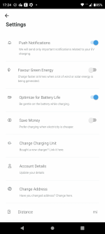

The only difference to mine is I have 'save money' turned on.

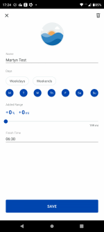

I have 5 scheduled set and they all finish at times 1 minute apart otherwise the app doesn't know which one to use as is picks the one that ends first, hope that makes sense.
