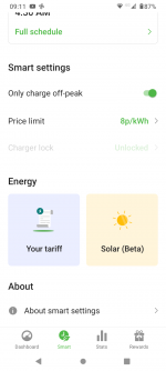

My ev.energy app does not seem to have the on/off option, where is that on yours ? My app version is 2.11.21 [6765] found at the bottom of the settings page below the log out button.

It's on the Smart tab. I imagine that it's only an option for similarly afflicted cars

App v2.11.21 [7004]
I changed the vehicle to an MG5 and the trickle charge on/off disappeared. When I changed it back to a ZS, as suspected, the trickle option re-appeared.
Tbc - I need the trickle option otherwise the car doesn't charge
