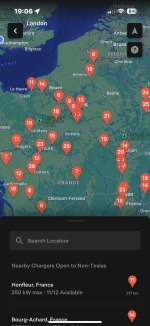

Useful summary of the details from Ricky Roy here…. CCS using type 1 not type 2 is significantly worse I think. Probable because home power in us runs on 110 volt not 240 volt - and in Europe three phase is common so type 2 is a good standard.
I'm traveling from the north of England to the Dordogne in August in my SR. Sucks to be me I guess?
Have a super time. Access to all of these? You’ll be fine.
NACS is great - but it’s not built with bidirectionality options as far as I know. Tesla has no interest in v2H/V2G - as has powerwall energy wing of business. ccs might allow for this in near future - so not all bad, even if less sleek!
