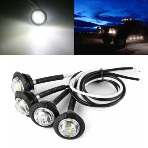

So in terms of bits, just some cable and four round 3 LED bullet button side mini marker lights, low power as I didn't need them to act as search lights.
That looks a better solution for me, I don't need the disco lights. A couple of questions if I may. Do you have a link for the lights you installed, how did you trace the wiring from new lights to map light and did you splice or piggy back onto connection of map light

Very smart, I'd deffo be interested too in those pillar lights especially! The back of the car at night is like a black hole!
