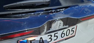

My Trophy has really bad condensation tn the rear spoiler and both indicator units. After alot of hassle MG agreed to change them, two days latter it's back. On a sunny day it's really bad, look's a right mess. My dealer has not been of much use telling me to deal with MG directly.
This affected me day 1, at the time (November 2023) I just got told it was normal to expect it to happen and that it would “dry up” which they do for the most part after heating up.
Doesn’t happen on the front - only the rear.
I’ve just learned to live with it. Doesn’t look great at all but it is what it is I guess when it’s so widespread and replacing the clusters doesn’t seem to work.

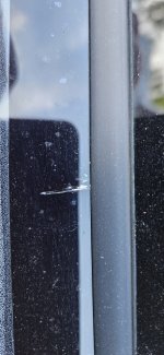

The clear plastic on my car has cracked. Has anyone seen this before?
View attachment 18297View attachment 18298
I have the same small cracks all the way over the center light up by the window on my MG4 Luxury from April 2023. I discovered it because there is fog on the inside. I think the problem has been there from the start, as I have seen fog for a long time.

Got my new MG4 Wednesday. Drove it through heavy rain first day, and lighter rain on Thursday and some on Friday. On Saturday the sun came back, and the fog problem revealed itself to me inside the left back light. Not much, but it's absolutely visible. Taking the car straight back to the dealership on Monday demanding them to repair it.
I have now read most of rhe threads on the "tailgate and back lights moisture fog problem". It's mind bothering how many people are persuaded by their dealerships, that this is a "normal and acceptable" issue. NO IT IS NOT! No car lamps are supposed to be taking in water. And cars are meant to be resistant ro rain, snow, heat and freezing temperatures. If a lamp can't withstand rain or a gentle wash, it is of poor quality or malfunctioning. As long as people are not delivering complaints, the issues will never be fixed addressed and fixed by SAIC.
