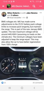

They aren’t reducing the range we have been told. Just reduced the top end voltage and the bottom end to keep useable battery capacity the same and hence the range the same.
I have the latest update and can now charge whilst unlocked. Voltage has dropped from 455v to 449v but my range hasn't changed.

The reduction in voltage is actually a really good move. Previously the fully charged voltage meant a cell voltage of 4.22v per cell. This is really unhealthy for longevity of this type of lithium cell chemistry. The new figure of 4.16v is much better. I just hope they aren't letting it drop too low to keep the range constant.
Yeah I did think they may allow more into the bottom voltage, but we will find out if this is the case when people charge from empty to full, because looking at some of the figures on here from people who have had the latest BMS it would now seem people have now got only approx 40kw capacity since the update. If someone who's had the update could say what their voltage is as soon as the battery light comes on and I can do the same, we can then see if this is the case, it's not that I don't believe what Miles is saying, but he did say on a podcast I had seen that he was told the voltage would go back up to 455v when the weather warmed up, which seems not the case now.
