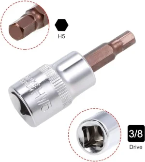

Thanks for the info, useful to know. I'm still toying with red but they are very plain. OK for black as they don't stand out but if you want them to stand out red would be better but needs to look more realistic. Thinking of trying these.
Did you actually buy these?
Really! I presume you have a set of tools. It will be one of them...
Have you a link to them please ? I was thinking of changing to red although my car is going back to the finance company in September.
Yes I did but had to modify them to make them fit.
