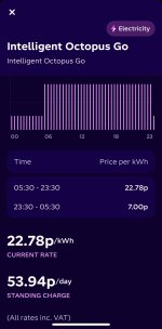

We are on Octopus with a Wallbox charger and the cheap rate is from 11.30pm till 5.30am which is more than enough time to charge a ZS to 100% and the rate is currently 7p per unit.
