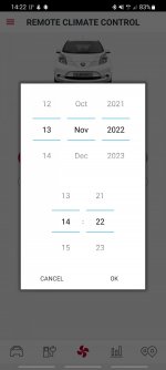

Does it work like Nissan, on the Leaf you can tell it what time to turn on.

No there is no timer for the pre heat.
Genuinely can't see why it couldn't be added to the app though.
Set a time and the server sends the message to the car.
